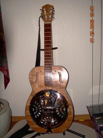

Hi Dave, I have built 2 squareneck resos this year. The strings are set at approx. 7/16 in. above the fretboard at the nut.The bridge is set to keep the same height all along the fretboard. On my first one I inlaid mahogany frets and markers onto a walnut fretboard. It is really hard to see them in dim light. On my second one, I inlaid white ivoroid frets and markers. They are much easier to see.
There is no saddle compensation on a raised string guitar. It is designed to play with a steel bar, and one must have a good ear. The frets are for refrence only.
I am not fimillar with Weissenborn. Do they have a resonator cone? If so, do they ues a biscuit bridge, or a spider bridge? I used spider bridges and Quarterman cones on both of mine. They sound really good.

Jeff,
Thanks for this.
Weissenborns are the hollow neck guitars and have no cones like these Lazy River ones. If/when I get the hang of these I might venture into the world of "cone" technology.

PostPosted: Sun Oct 15, 2006 12:11 am
[QUOTE=hogan] [/QUOTE]
Jeff,
Lovely looking guitar
PostPosted: Mon Oct 16, 2006 12:42 pm
Yes, really nice indeed!
